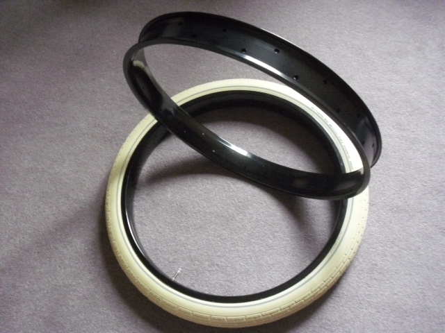

The tyre is fat frank 26" x 2.35" on 65mm wide rims.
