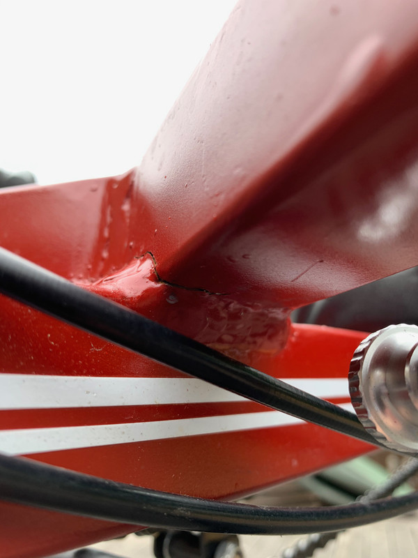

Hi Folks,
It's been while since I posted anything on here (although I have been a visitor in the background) and now I'm back asking questions. So my apologies for that.
But I just completed my weekly once over on the Fox and have discovered that the main body to boom joint has failed again 😕 Five years ago this happened and I took my Fox to the local agricultural fabricators and they re-welded my original joint. Since then I have been doing a weekly visual check of the Fox just to make sure I am not caught out or worst still CRASH !
I've really got into my trike again this year, having completely eliminated my shimmy issue altogether and doing over 500 miles since lockdown began here in the UK. Now this ....
I could go back to the fabricators and ask them to re-weld it again. But it is likely to fail again in the same place. So I need something a bit more permanent as a fix this time.
What do others do for this joint ?
I'm guessing that I'm not the only one to have this issue ?
Given the stresses on this joint, in all directions, this has got to be the most vulnerable joint on the Fox.
Some pics of your solutions would be really very helpful.
Thanks all, I appreciate your help and advice in advance.
Cheers
Si

Looks like you need to add some gussets. You can make them from the same tube as the frame to fit fore and aft of the joint, and can also add a pair underneath, left and right. Given the angles of the joint your gussets may need to be made from several pieces.

A simpler solution would be to make 4 plates shaped like this out of 2 or 3mm plate and weld them on fore and aft both sides. Make sure to weld both sides of the lower part and under the top tube for maximum strength. Either solution would require the grinder out around that crack and that welded up first. It'd be simple enough to notch the plates with a grinder at the point of that large weld so the plates sit flat. Either that or that weld needs flattening off. The former is the better option.

The gussets will certainly do the trick.
It's actually a strange failure considering there is not much stress at this point of the frame. On a 4 wheeler, there would be, but on a trike, any side to side would not be met with resistance at all. I can only guess that there was some weld anomaly originally, and they just chased it when doing the repair.
Flap disc the paint away from the joint, weld in the gussets, and then reweld that joint, ahead of the crack.

I think the clue lies in that phrase ?
I don't think you have eliminated shimmy ? I think you have added a steering damper on the left front wheel ?
I suspect that it is transferring all the energy of the shimmy into that left hand joint ?
Whether that is correct or not ? adding more weld will not fix this problem !
The weld just makes the joint thicker at that point and so the stress then concentrates on the nearest thin section , which is why the cracks appear alongside the weld/tubing junction.
The welds themselves have not failed the tubing has.

I'd suggest that there is in fact a lot of stress there. Any potholes will jar a three wheeler quite easily and more so than a 4 wheeler. The three wheeler will always dip straight into any pothole as it finds the three lowest points of contact. A 4 wheeler will hold the wheel at the pothole up to some degree by balancing to some extent on the remaining three wheels. Any force applied to the wheel from pothole and rider has half of the track width to lever against that weld. In an ideal world the tubes would be the other way round with the main beam on top so all the weld was doing was holding the tubes fixed though I'm well aware the Streetfox is designed to be as simple to build as possible and a dropped axle would leave that ethos behind.
Paul's point on the damper is definitely valid. If there was a shimmy it was probably the cause of the original failure and after fitting the damper the force is still going into that weld but not at the same rate. Nothing will kill a weld faster than an oscillating force. The caster is probably the key to the shimmy as mentioned. Failing a castor issue I'd look to a wheel bearing or a bent axle.

Wow, thank you for such fast responses and great advice. I shall try to answer all the questions and queries.
I dug into my files for my Fox build to see if there were any clues there. Being my first time welding and doing a project like this I did try to follow the plans as closely as possible.
The axles are 14mm BMX, and from my notes it looks like I was shooting for a caster angle of 15 degrees, as per the plans.
Here, some pictures of the original fail.
As I say I took the frame to the fabricators in the village and they re-welded the joint.
BEFORE I did that I did mock up some gussets based on angled steel, which would be welded to the main tube, with a vertical plate which ties to the boom tube.
These would sandwich the main tube.
My idea here was that using angled steel as a base for the gusset, this would be one piece of steel, so no weld to fail at the right angle between the main and boom tubes. Then the vertical section is added. The appeal was also that apart from the three inner 90's the welds where are easy to get to.
Anyway the fabricators re-welded my joint made a much better job of it than I did and it looked OK.

Before I spotted the fail after it had failed on both sides. This time I have spotted it early. As before the weld has not failed, but the steel next to the weld.

So I have stripped the Fox down and boxed up the parts.
Out with the angle grinder and a wire wheel to strip paint and expose the extent of the metal tear.
As suspected it is the thin wall of the box section steel that has failed, where it meets the thicker weld metal of the joint.
My thoughts are to flap disc the weld metal profile so as to take it back just a little into the right angle where the boom for the arms meets the main body tube. Then I will use the angle iron to form a gusset as per the previous posting (GREEN part) below.
I may need to knock off the outside right angle of the angle iron to allow for the weld metal I do not remove from the joint. But I could replace this on the inside of the angle iron once it is welded in place.
Then the two tie plates are welded in place as shown (BLUE parts). These are welded to the boom arms fore and aft on each boom and welded to the angle iron, on the top and underside.
Re-weld across the front of the boom to main body joint to strengthen this and repair the last few mm of the tear.
