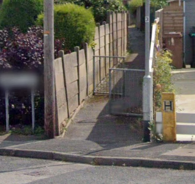

Ok pushing the envelope , well someone has to ....
No previous trike has got through this barrier , now I can with inches to spare , looks like I could do 26" instead of 24" and still get through ? more luggage space !
Really need to try with 24" wheels instead of 20" before committing though.
