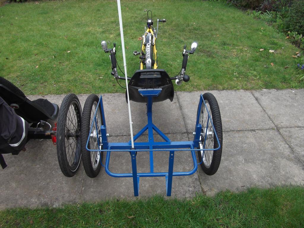

hi all
So done a bustlectomy and taken 4" out of that , result ? made trike shorter by 4" which is the same as increasing the w/b by 4" so should improve front end traction as well. Win Win me thinks.
Downside well it will move the panniers further towards the seat and then there could be some conflict with the axle securing bolt , need to look at that when it is fully assembled again , Sunday with a bit of luck.
Then welded some more steel to the frame ?
The 2 wire parts nearest the camera are for the tent to - rest on & to strap it to .
Now the more observant of you will see that is becoming a bit of a pig in a poke adding stuff is creating a scenario where some of the steel is now redundant and there are far to many welds ! So much for forward planning :)
The lower wire frame and 2 braces could have been replaced by a C shape like behind the axle and the front vertical loop could have been replaced by 2 verticals ? reducing the steel used [ weight ] and welds down from 9 to 4 ! hey ho ....
Bring on Hindsight ;):)
Same goes for rear bustle ..
You can just see the internal sleeves I had to put in the axle holes that were made for the ' wheel chair ' versions that are 16mm and I am now using axles of 12mm instead.

2,904
Well it is back together ...
Can you see the missing 4" ?
Before :-
After :-
.. and like the curates egg ?
Has some good parts ...
Tent goes here :-
May need some short pillars to stop the straps riding off the rod they are wrapped around.
Then tent and 2 panniers :-
then with tent and all 4 panniers :-
Ok still lots to do but progress is being made.
