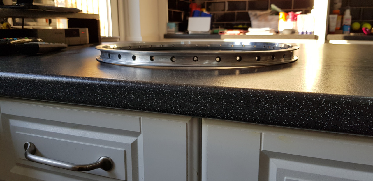

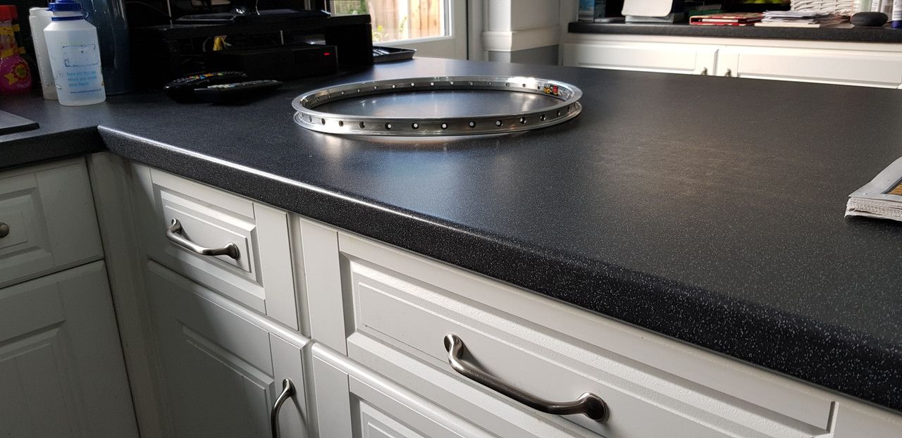

And this is the same rim after a 15 minute "quiet discussion" it had with my feet and some timber.
I might be able to save it after all. 🤪
Phase 1 .... "I'm very disappointed with your attitude".
Phase 2 .... "I see you are coming around to my way of thinking; there is hope for you yet".
But can we ever trust you again?

It is only a little bit more buckled than a rim with a broken spoke. Enough pressure in the right direction should fix it if it is not cracked anywhere. It makes the wheels that I have re-purposed look pretty scary and I haven't had any trouble. But then, I don't try to find performance limitations.
My last buckle ended up much the same as yours when I hit a sudden level transition in the dead of night. A few clamps, vise grips, terse words, etc., and it was soon better than it started out. I couldn't tell the difference between it and a new one and I'm sure that judging by its donor, was a very cheap rim.
Could you trust it again? It depends on how much you stress it. A bulldozer is probably a better choice for trying to move bollards though.

Where's your sense of challenge. Your can-do attitude.
Remember you will get further with gentle persuasion and fineness, then stomping on it.
If car shops can straighten car frames, you should be able to tweek an itty bitty rim....right?
My thoughts go immediately to the process of truing, a wheel. Not saying that will work here, just a path to look down.
Looks like you have a good start. If you should accept this mission, remember that the metal has a memory,
and will require adjusting back past the 'sweet spot' thus allowing for 'spring back'.
If it is destined for the trash bin, then nothing is lost, but knowledge will be gained.
Oh, and then there is the entertainment value for the rest of us......:ROFLMAO:
Please record your efforts, jigs, persuasion tools, etc. so we can all learn from this experience.

We had a few more "words" today and I think this is the best I can get.
The rest might come out in the truing of the wheel.

Looks good from here , how many mm do you think it is out ?
It would make a good wheel for a test mule like trike where you might ride it locally but not go on longer trips with it...

It is still about 3-4mm out I think. There is a pronounced distortion in one chord area. I might be able to take that out if I can clamp the chord in a vice and yank on the part of the rim just above the chord.
As you say, still good for "second-best". Actually, I have another set of entirely good rims & tyres of exactly this type in the shed that are attached to the DRM hubs of the late WD-2. Those will need a new purpose in life at some point. Saying that, I wonder if I can re-use them and my cable-operated disc brakes on some swing-arms? :unsure:
