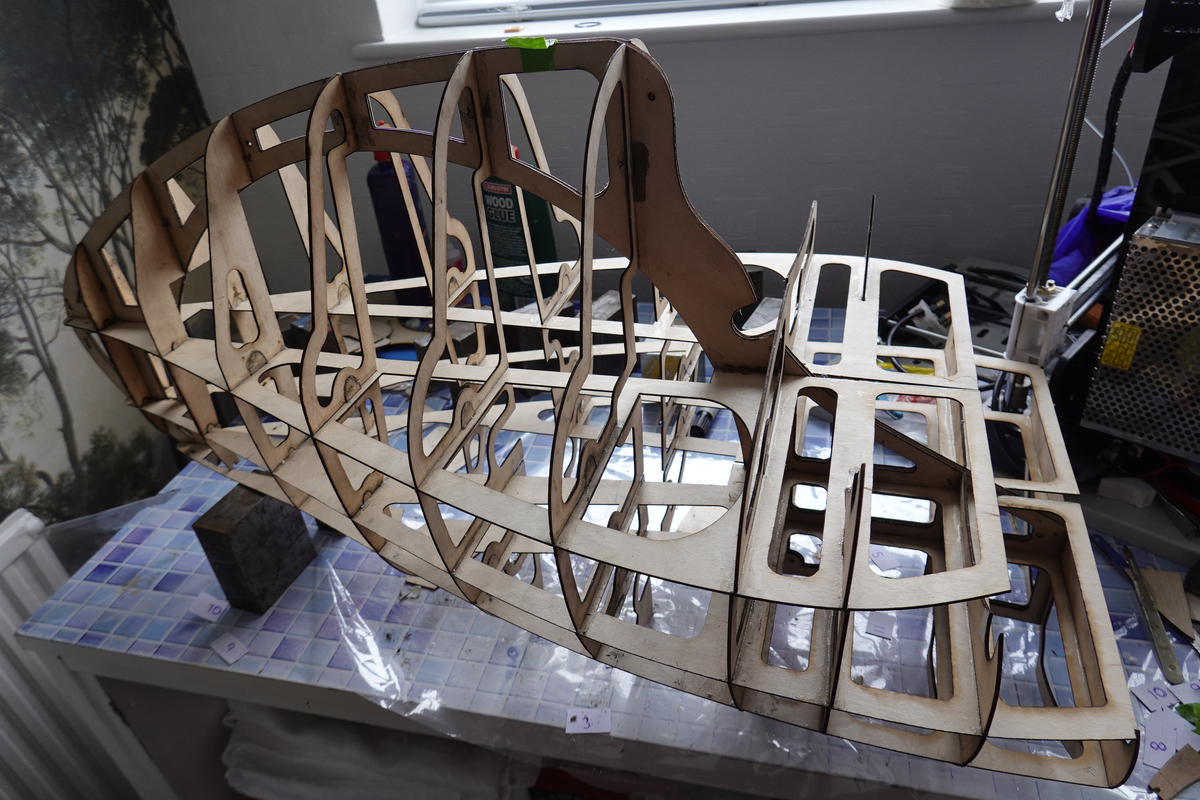

Frames like this which I've nearly finished for a Greenspeed Aero trike.
I may use this fairing as it is, covered in polyester heat shrink, or nylon and dope, then use that to make a quick mould to produce a carbon fairing, current weight 850 grams.
Been running with the Carbontrike SL racer fairing with great success this year, weighing only 1 kg.
Impressive ! Are you laser cutting aero plywood from 3d model slices ?
I d love to learn that i am old school model plane builder
